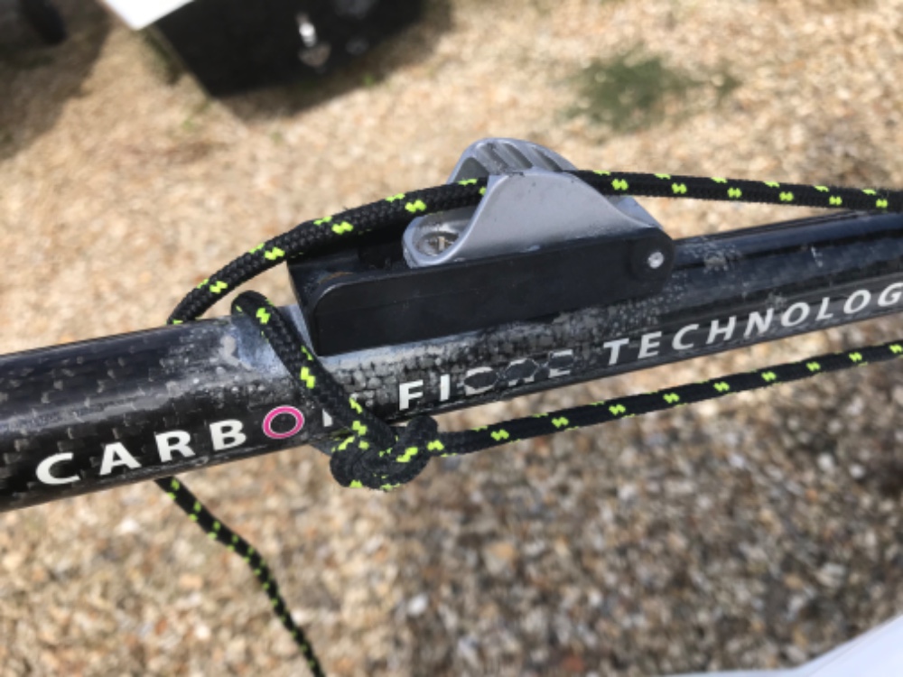

Hi Geoff,
You could tie a tight loop around the far side of the cleat, as in this photo

How do you deal with the lack of beckett on the CL257 to get the 2:1 pull?
