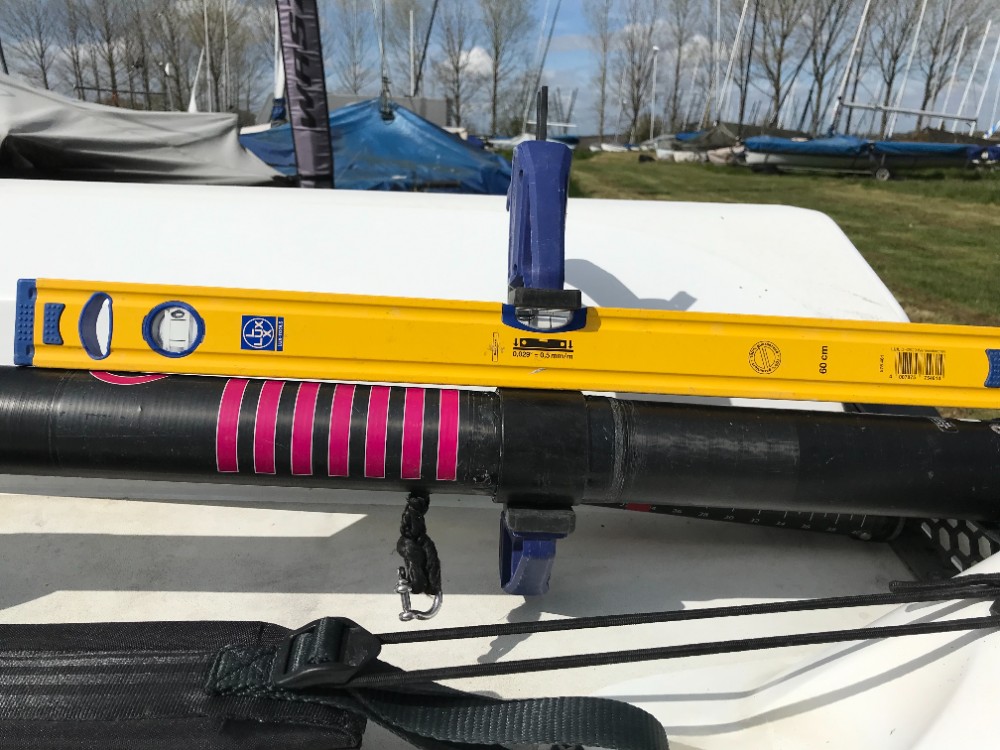

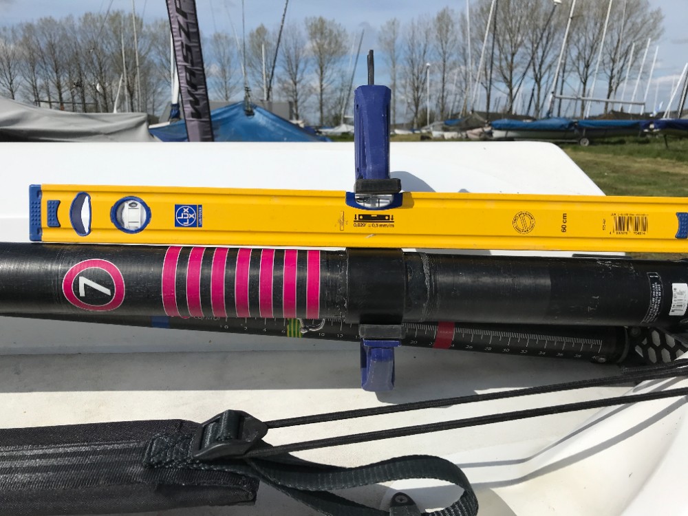

The 7 mast Collar was just pushed up over the boss on the mast and is not quite aligned to the mast; it's only a degree or two out in both fore -aft & port - stbd planes; but it jerks & makes loud creaking noises when sailing upwind on port tack & playing the mainsheet. The stronger the wind the louder the noise.
the 9 collar was pushed on with a fine helical screw thread motion, and is better aligned, but it too makes some noise when rotating; albeit a lot less.

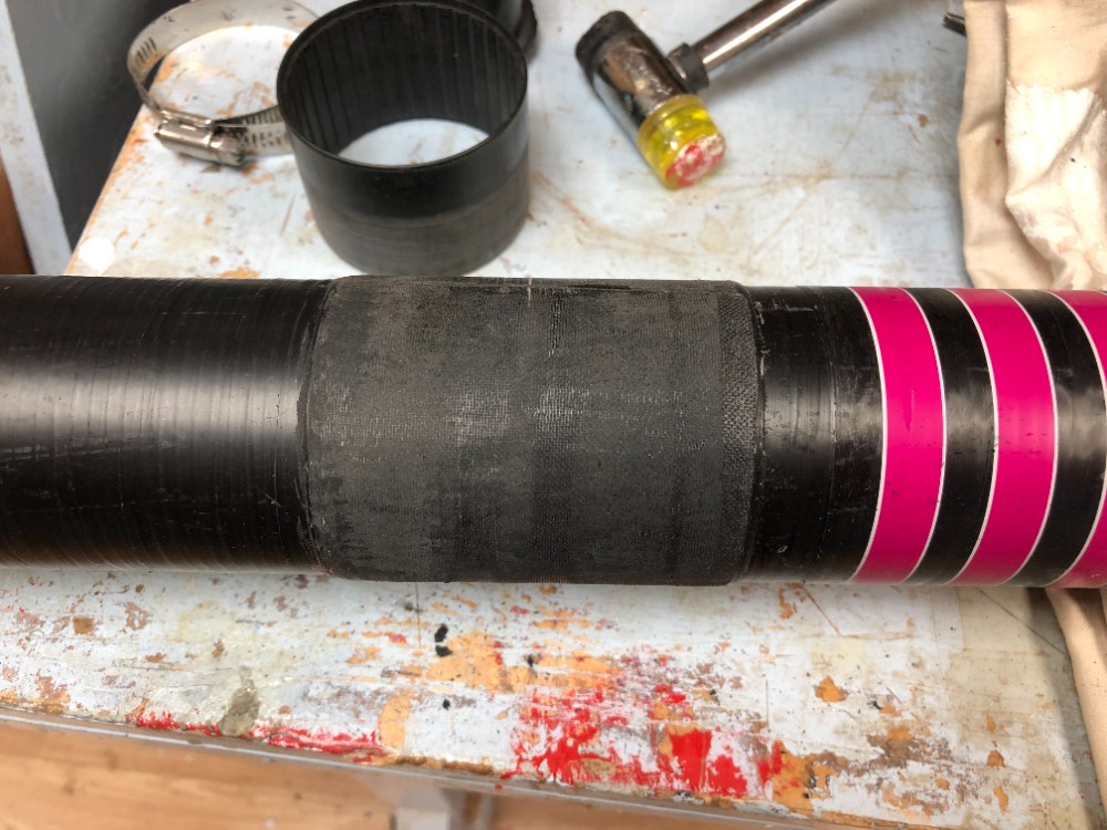

The mast collar has been floating about for the last couple of weeks but only noticed when racing on Sunday so time to fix it - Thanks Hairsy - the trick with the jubilee clip worked a treat to remove the mast foot undamaged. I have removed the rubbery type substance that was either side of the collar but now looking at the mast - does this slightly thicker material need removed? Mast is around 62mm diameter and at the mast collar area it is around 64.4mm diameter. Does this have to be brought down to 62mm or just roughened up?
