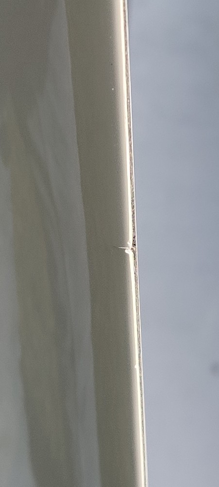

Also, my foils at the leading edge have quite uneven bond gaps. At some points the gelcoat joins without gaps and at other points there is a 1-2mm gap.

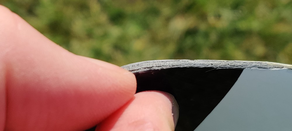

A bit more data: My 3414 centerboard and rudder did not have any asymmetric bevel when delivered. It was rounded and looked like it just had a bit of sandpaper run over the trailing edge. My first Aero 1250 centerboard had a very marked asymmetric bevel. The second Aero 2500 had a bevel too, but less. The 3414 boat eliminated the bevel completely.
However, I've since put a 3mm 30 degree bevel on both foils and the problem while reduced a little, is still there.  I took great care and made a jig to achieve a very even, 3mm bevel at a constant angle. I'm reluctant to increase the bevel beyond 3mm and would need advice from RS that this is required.
RS have asked I check for voids and places where the gelcoat may not have adhered to the core. I've tapped around and do get some varying sounds, but I can't determine if the gelcoat is adhered to the core or not. It has not delaminated in any spots.

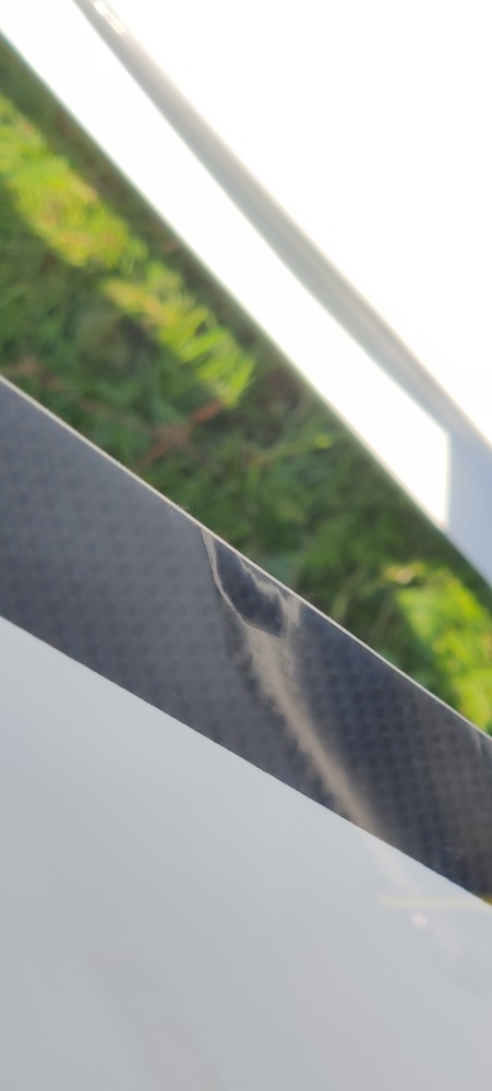

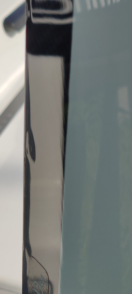

Hope everyone is doing well, especially during this tough time.
Recently traded in RS Aero, upon receipt of new boat the build quality hasn't been great. The first hull had to be replaced due to imperfections. However RS where great in facilitating this so due credit there - life happens and things do go wrong.

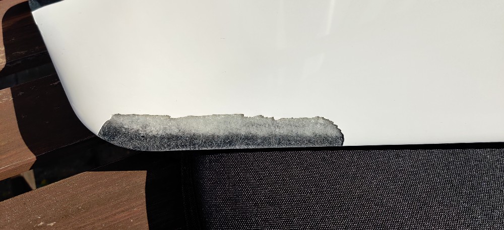

On the maiden voyage, after the replacement, last Monday. I noticed a strange hum (super excessive) The daggerboard delaminated and gel coat pealed back. RS again jumping straight in to rectify the problem and replace the foil. So despite the issues I'm being looked after. Although the problems I'm glad RS have been open and transparent and immediately sorting things out.
However today, 12 knots gusting 16-18knots wind. I still had humming from the boat. Which I'm pretty sure didn't exist on my first RS Aero. Or atleast until I was hitting very fast speeds 15knots+.
Its been so long since I've sailed (lockdown) maybe I'm just over analysing things considering the quality issues and I'm hearing humming that should be expected at ~11 knots. However at same time I feel the hum is far too pronounced and is almost like a laser which I know the RS Aero is known to be better for.
Normally humming is due to foil issues; alignment, imperfections or not fitting the casing correctly. Although it can also mean a warped hull (I hope not). Although everything looks pretty on par and I'm struggling how to diagnose or if I'm being over analytical of the situation I'm in.
The only things I've noticed are:
  • There is a small gap in the under gasket for daggerboard case at the fluff towards the stern side (3mm at most). Could water be jetting up there causing this to happen?
  • The rudder foil could be imperfect, the trailing edge (black part) is about 3-4mm longer one side than the other. Could it be that this imperfection causes enough imbalance to cause an excessive hum.
