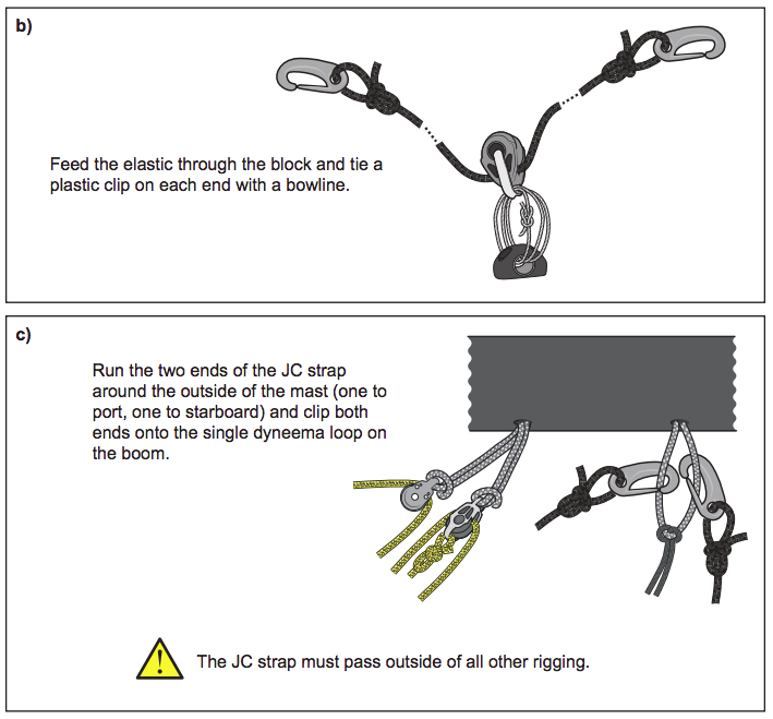

Hi Phil,
A 'JC strap' to pull the boom out is permitted.
The limitations are covered in the Class Rules and the rigging description can by found in the Rigging Manual.
Both of those documents are available on the  Documents Page of the Class Website.
08/11/2020 23:49:00
Apologies if this is covered somewhere else . Do the rules allow the boom to be pulled out by elastic for light airs ? If so what are the attachment points abd ideal / allowed diam of elastic . Thanks
