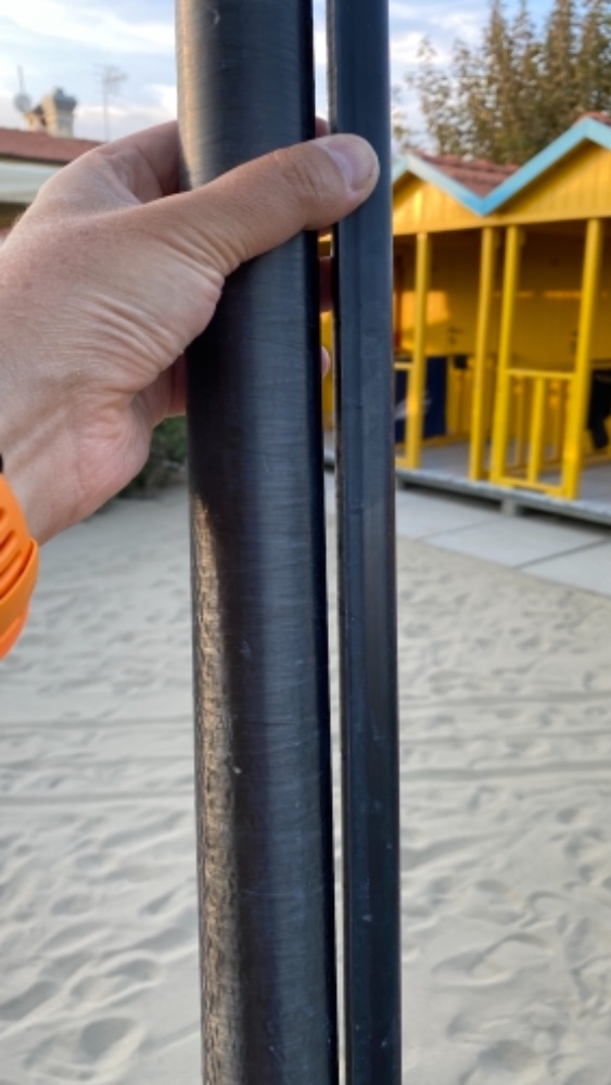

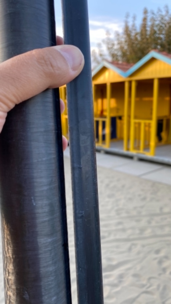

Hi Chris,
I have the same problem with the center section of the upper mast track.
I think the main cause is the long exposure of carbon and glue to the sun that could have dry the adhesive (my Aero stays for the entire summer on the beach) and a capsize event.
I am searching for some advice about what kind of glue or resin to apply to fix the track to the mast again.
Anyone has an idea?
Ciao
