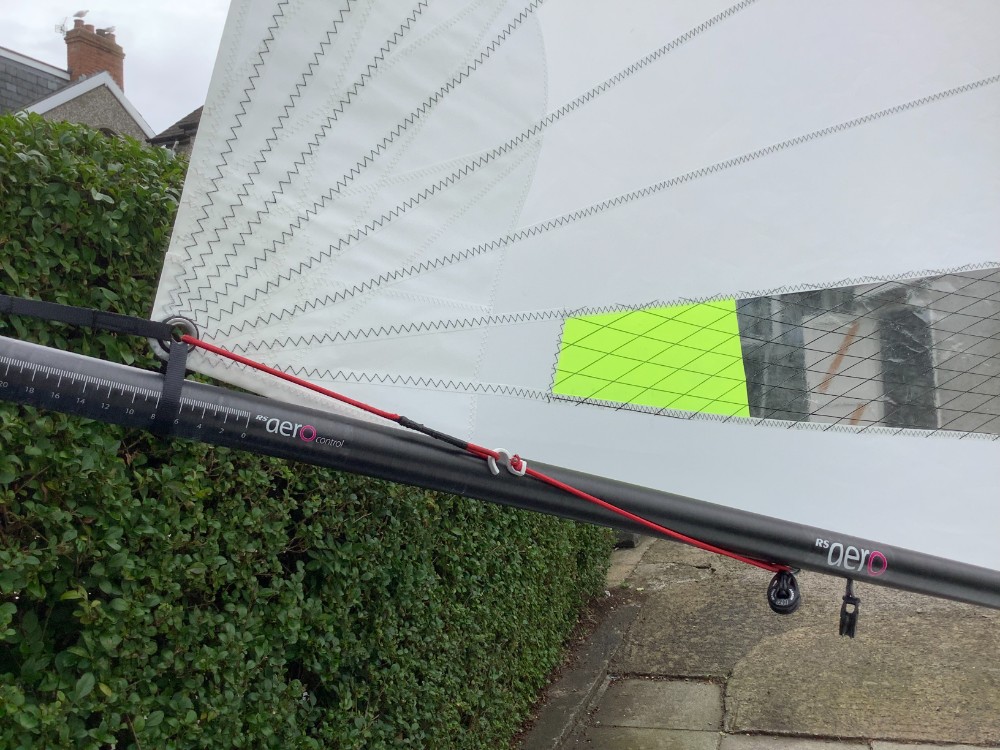

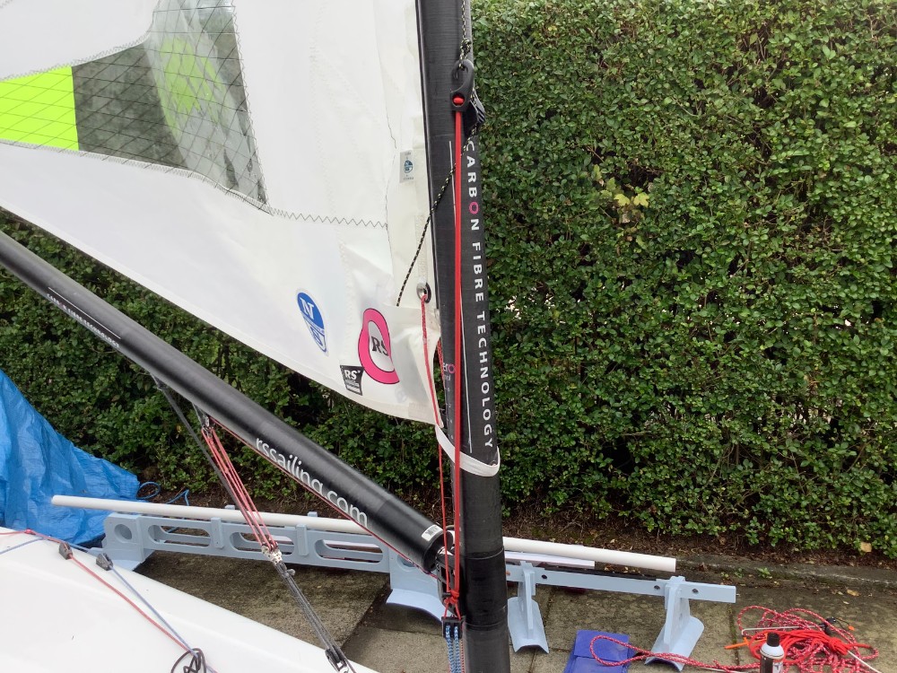

Here is another way which does not invlove any blocks, just two plastic clips and works really well.  On the cunningham the loop tied in the halyard  is just above the cleat and serves a second purpose in letting me know the halyard is fully up.  The outhaul bungy on the sail has a loop in one end so it goes through the clew ring and again a plastic clip.  Both systems are very quick to rig and de-rig.

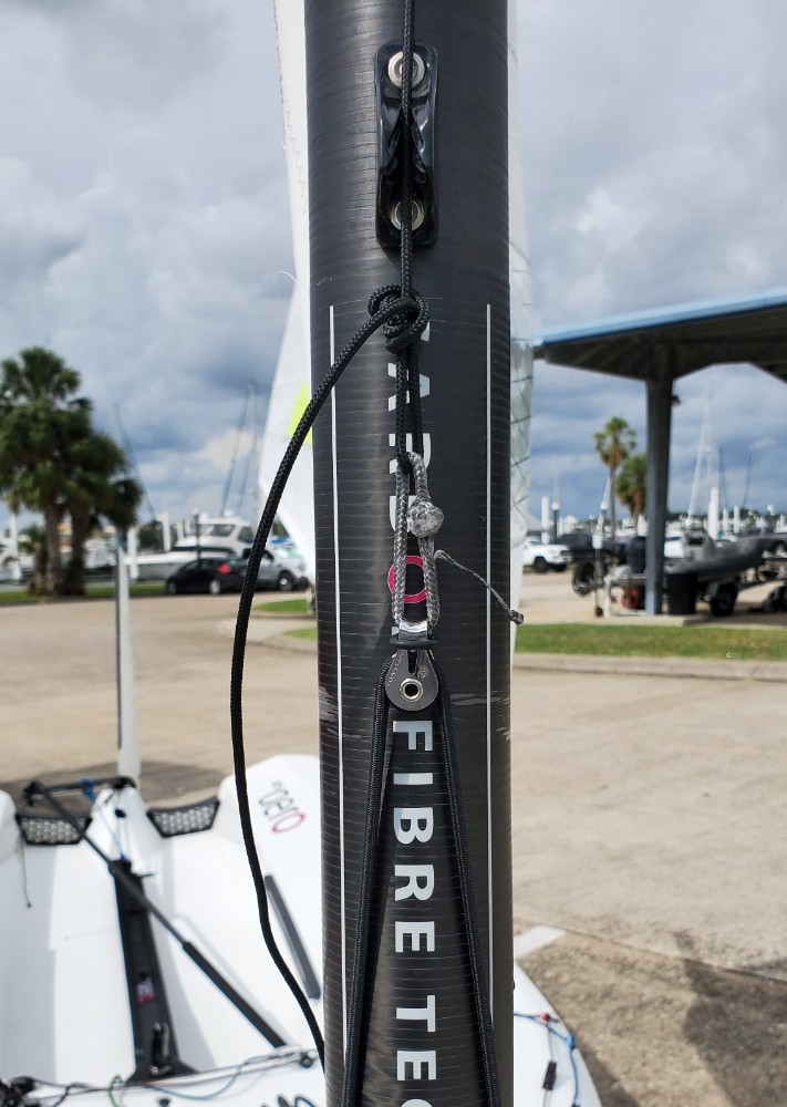

Here is what I have been experimenting with. One loop on the main halyard just below the cleat. One soft shackle for quick release (rule C.6.1.3.n calls for maximum 5 seconds). One very small light block. One piece of 4mm bungee. The bungee has a bowline on the Cunningham block and snap-hook to the Outhaul block. The small block makes a very nice equalisation of the bungee tension between Cunningham and Outhaul. Works a wonder, but I am not sure if the small block is fully class legal.
See pic.
