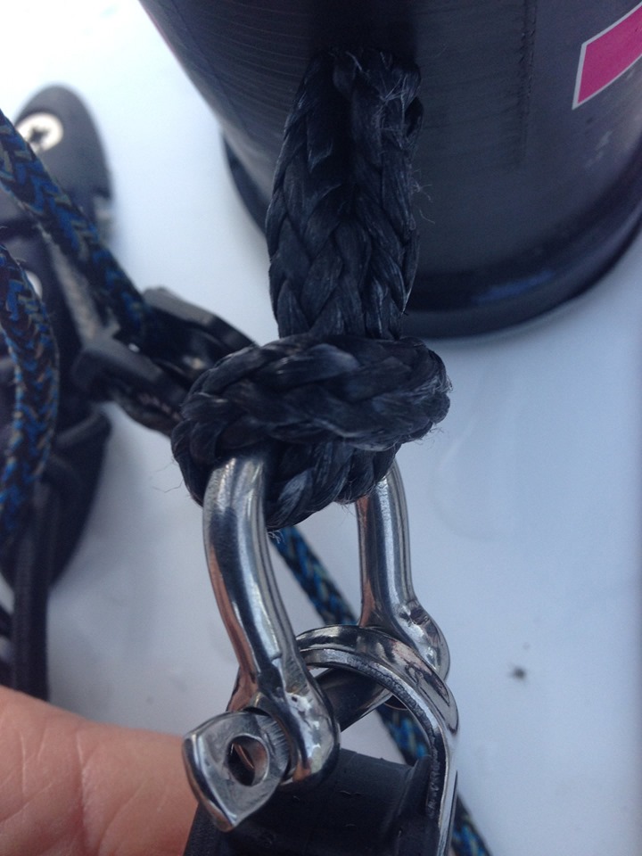

I would expect some bedding in of the diamond knot under load but perhaps not 2" each side. However, even a bedding in of 2" should not make it unusable. You just adjust the other knots in the system, there is still plenty of range. If you want to keep the system the same for 3 rigs you could add an extra cow hitch or turn around the shackle or loop to reduce any difference, or use no cow hitch on one of the rigs, the cow hitch is not critical (although the benefit is reducing the load on the dyneema and never losing your shackle). For example, I have a cow hitch on my 9 & 7 rigs and am aware that I might not need one with my 5 rig with the slightly higher boom, if I am to avoid adjusting the rest of the system.

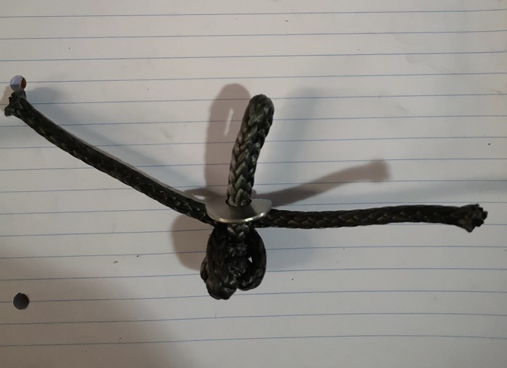

- A simple home bimble alternative to the diamond knot is to tie the original double overhand knot and thread the two tails between the knot and the washer. Tests by Selden showed this to be very effective at minimising any slippage from with the double overhand knot. (See photo in this thread)

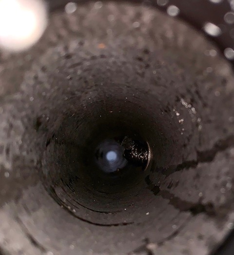

I had a thought - does this have an inner that takes the load and, if so, could the inner have given way and I'm now left with the outer which is why it's now longer?
Just seems an odd thing to have happened.
I've added a picture from inside the mast in case that helps - I assume this is what I should expect it to look like.

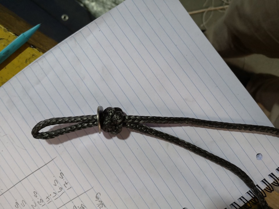

Although I can't be sure, I think the dyneema loop for my kicker has slipped. It is 14.5 cm long and I'm fairly sure it was shorter than that. Picture below.
Can anyone confirm whether this is too long? If so, Can I pull it out and put a knot in it and then reinsert or does it need a more sophisticated fix or replacement?
