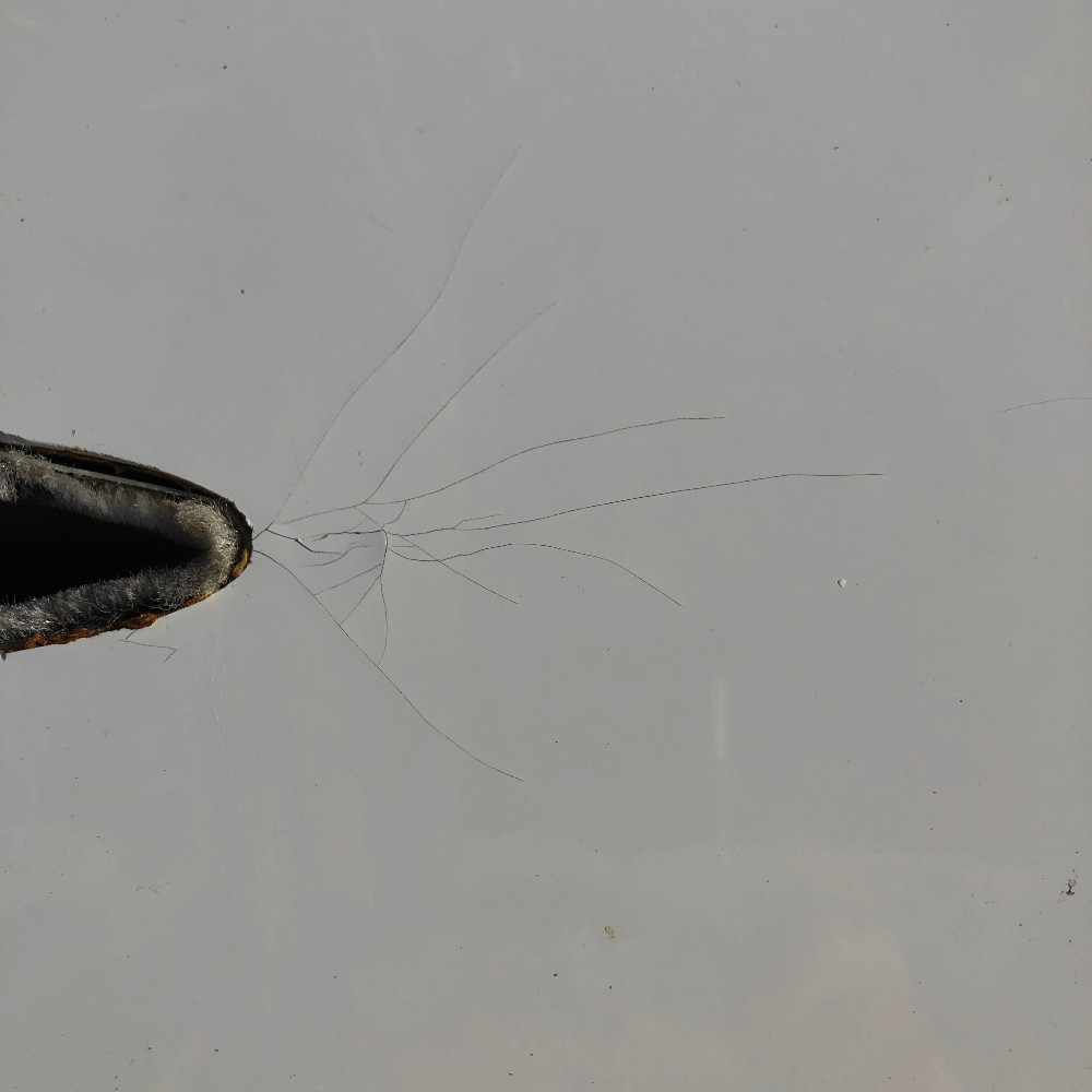

Hi, I've got a crack just ahead of the centerboard case under the hull. Would that be the same sort of problem you discussed above?
