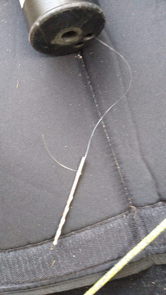

I put a new outhaul line in today and here's a picture of my method. I tied a length of fishing line to a drill bit (more than double the boom length), leaned the boom vertically against the house, and raised and dropped the drill bit till it eventually fell through the right hole. Took a minute or two.
The other end of the fishing line was tied to the outhaul with some tape making a nice taper, then I just pulled it through.
