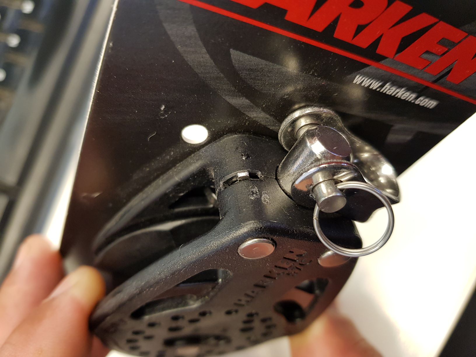

Hi,
The H2135 Ratchet supplied with the RS Aero does have the ability to lock its base post in position.
Lock the pin @ 90 degrees to the direction of the mainsheet. This will mean the ratchet will follow the mainsheet cleat jaws and lean in towards them.

Hi
In answer to two queries in this thread, about the block being able to swivel independently of the cleat ...
You should be able to lock the swivel head of the block, so it remains in line with the cleat.  See https://www.harken.co.uk/uploadedFiles/Product_Support/PDF/M1005.pdf for details - "3-Way Cam-Lock" on page 3.
If you're running the sheet from the ratchet in light airs (i.e. bypassing the cleat), you should be able to stop the cleat arm swinging with a piece of elastic tied to the traveller fairlead.  I don't think that would contravene the Class Rules!

Hi. I think our exploded diagram may need editing slightly to make things a bit clearer. Accurate terminology may help the explanation. There are two types of Shoe that slide in and lock. One fits to the bottom of the ratchet (a) and one that fits to the bottom of the Cleate Base (b) A standard boat is supplied with a ratchet and Shoe a. The Cleat Base is supplied with Shoe b prefitted. Upon purchase of the cleat base you remove the ratchet from Shoe a and attach onto the Cleat Base. Job done. To go back to just the ratchet remove it from the Cleat Base and fit it to Shoe a. We will endeavour to tidy up the exploded diagrams to make this clearer. Kind regards RS Customer Support
