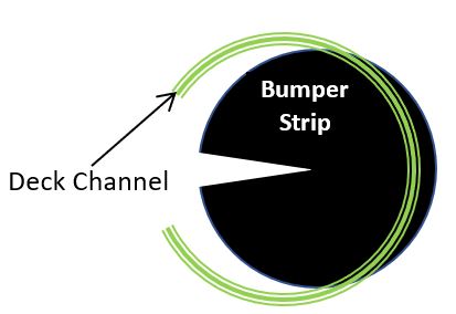

Mike - thanks again, helpful as always. I am cxoming round to the idea that I should tap the bumper strip ouot of the bottom as you did. That should make it easier to refiit from the top, which makes sense given the taper. Looking at your sketch, to drive it up from underneath would require the strip to bend slightly to pass the ridge. Given how rigid the strip is, that seems unlikely. I have one further question, if I may. When the bottom of the strip is flush with the hull, is the top flush with the deck or slightly below?

Here is a sketch showing the bumper strip relative to the deck channel on the Seattle Fleet Loaner Aero.
Based on the explanation by Dave and Ivor, this might be the same problem they faced.

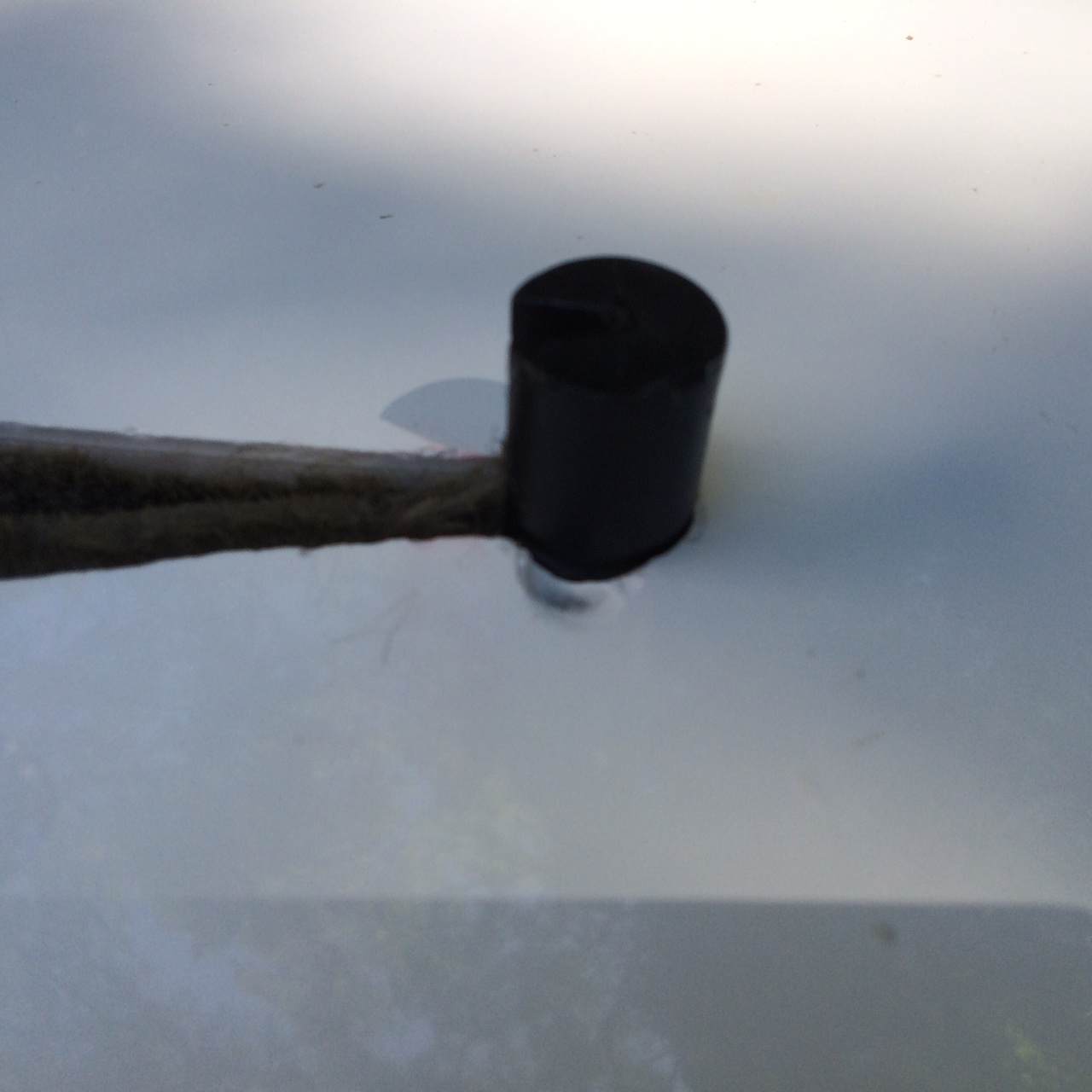

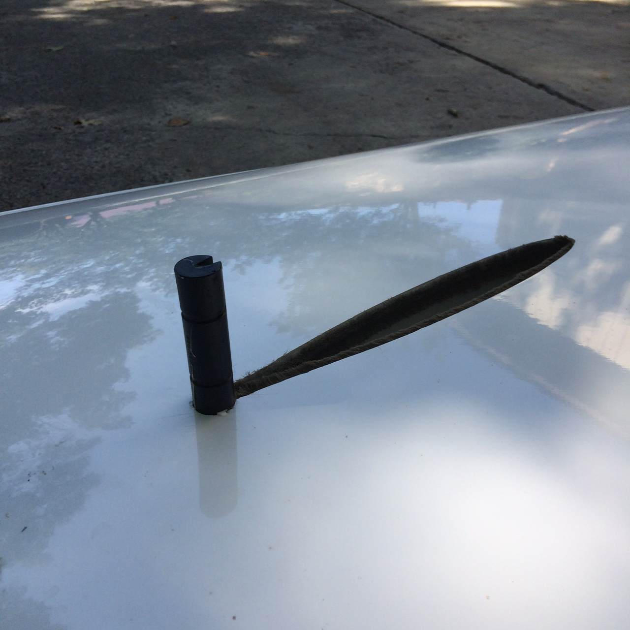

the pictures at the bottom of this thread were from my boat. Peter's plan looks good to me - mine was a bit more complicated as I could not knock it all the way back in so after knocking it back in as far as I could I actually cut off the bottom bit and reinserted it in the top using 5200 - this repair has worked great for 3 years now...
Full details on what I reported back to my dealer in the USA are below...
"I have done the repair - but I could not pull/push the guide out through the top - it keeps hitting this ridge in the molding about 2cm below the deck - I even drilled a small hole in the top of the guide and inserted a long screw into the top to try and guide/pull it but that did not work. I also tried to pull it out the bottom but as RS say the casing or guide is tapered and it jams when there is about 15cm pulled out of the bottom.
So I went to my plan B - carefully cut the bottom 2cm off of the guide, pushed the longer part of the guide back in until it was flush at the bottom with some 5200 to secure it and inserted the 2cm piece at the top with some 5200 talking care to keep everything aligned. This morning before the 5200 was fully cured I tested it by putting the daggerboard through and it felt good"
