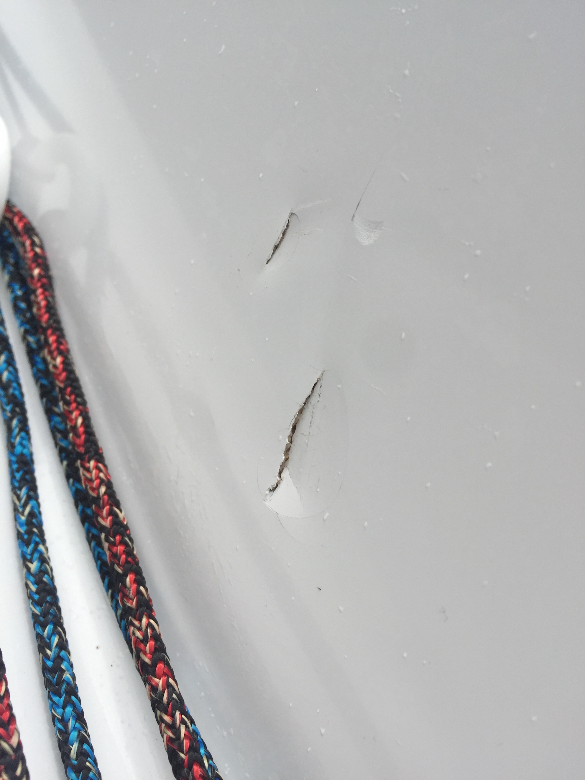

Caution-Those are puncture wounds and there is liekly to be more damage on the insdie-the inner skin will have split away and will need a fairly extensive repair I am speaking through personal experience and I would suggest a professional repair

Guikitetri,
For a sure answer you would be best contacting RS Aftersales on [email protected]

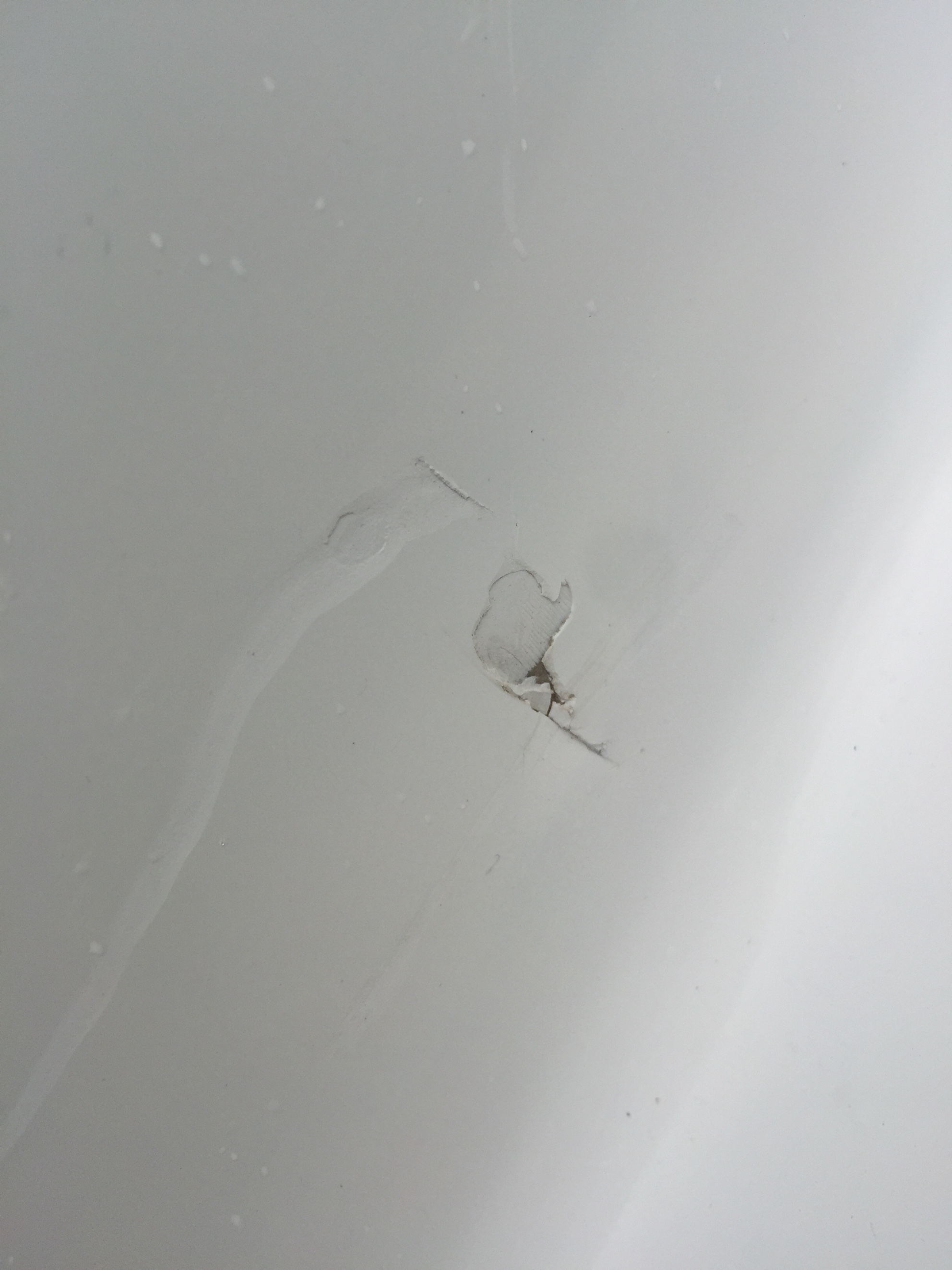

Any suggestions on what to do first here, before applying the gelcoat???  I'd really appreciate a step-by-step list of how to repair this puncture on the hull:

I have a punture on both sides of the boat, in the middle, Under the gunwale, right about where the boat sits on the trolly (where the handles are). I realized that the blue plastic covers that protects the boat from the aluminum, had slipped and mostly like the when getting the boat out of the water, the hull hit the aluminum edge. Any suggestions on how to fix the puncture and make it looks nice again?

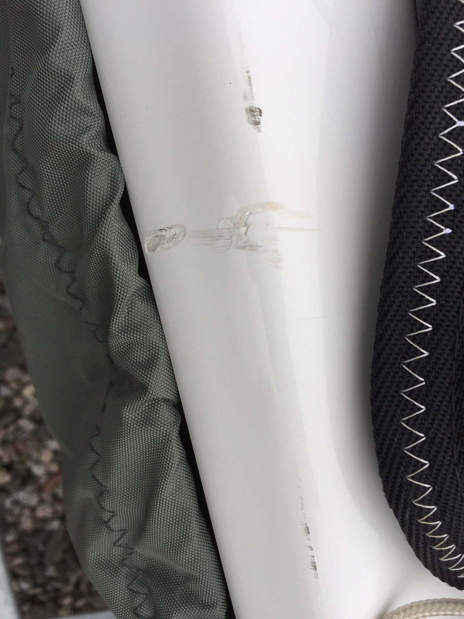

Here's another bit along starboard bow

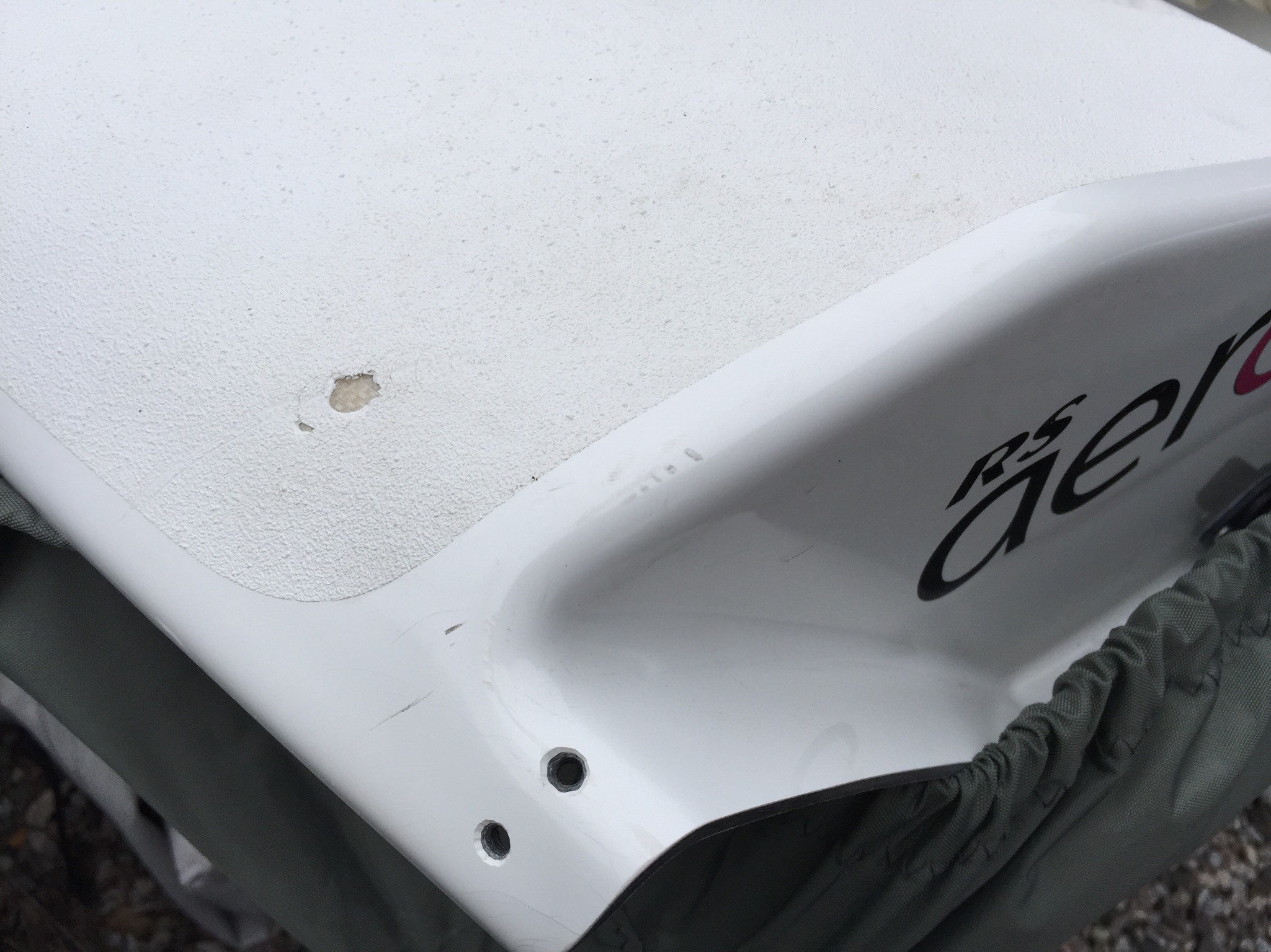

What are people using for minor gel coat repairs?
