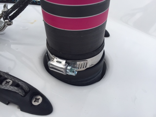

It's probably worth a try, but I'm not sure it would be strong enough, unless they make some really beefy cable ties. I first tried a thick wrap of duct tape above the collar, but the collar rose right through it in a Force 5/6.

Would a cable tie work?

Yes, I assume that if RS were to make one, it would be black plastic, maybe a two-part clamp.

How about a plastic one?

Yes, but I doubt they will do that for everyone who has the problem. I just noticed that hose clamps are also made in stainless steel, so it's potentially a permanent fix. Alternatively, RS could make a custom part to do the same thing. Probably a lot cheaper than replacing many lower mast sections.

The plastic collar at the base of the mast, which acts to prevent chafing and to keep the mast firm in the step, has come loose. Once it does, it slowly rises until it's out of the step, and then the mast starts rattling around and making unsettling noises. Evidently it's a common problem, and RS has provided a replacement adhesive. But it's not easy to get the collar off, and reapply adhesive in a way that it won't happen again. So here's an easy fix: a hose clamp attached just above the collar. Even if it eventually corrodes, at $2 it's cheap to repeat. Works like a charm.
