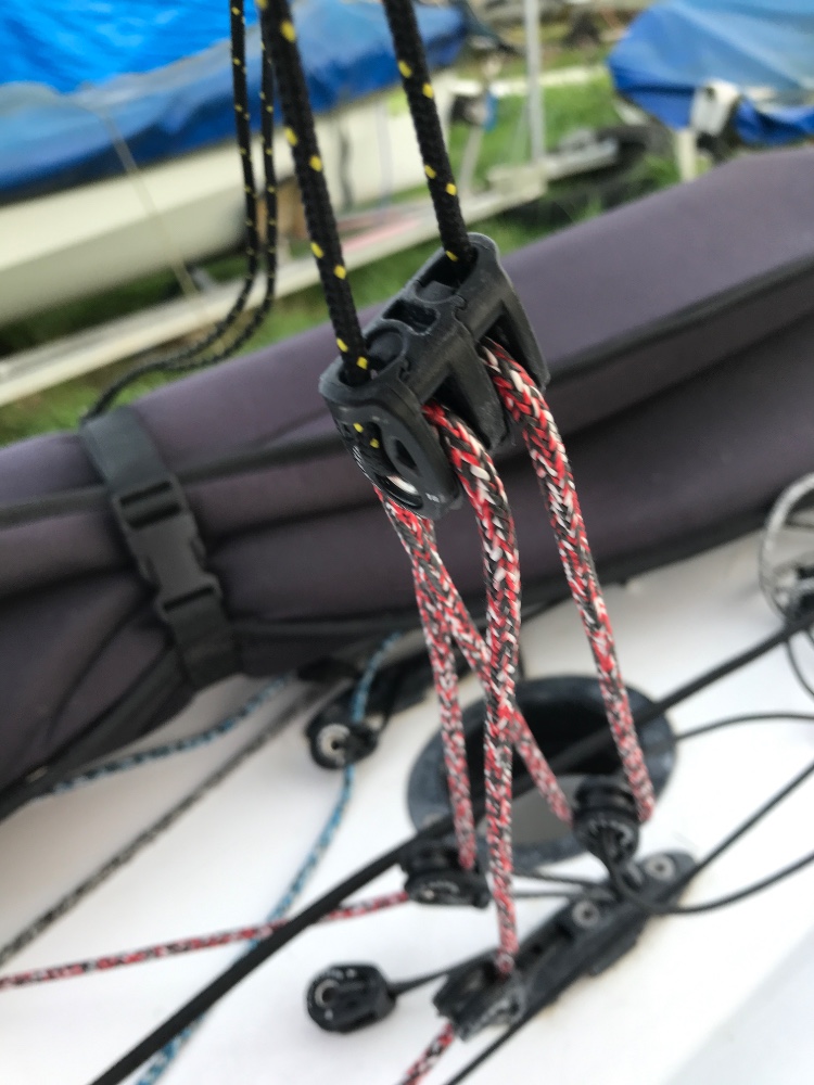

I have used Marlow Ropes Excel Vectran 3 mm diameter.
Photo shows it threaded through the Cunningham upper double block; no problerm threading.
I bought sufficient for two long tails that make up a doubled working part the same length as the original RS tapered line.
And tie the ends together in a double figure of eight knot.  In several years of using: on two Aeros with all rigs this has not jumped out the goose-neck.
The Vectran is obtainable form Pinnel & Bax, cut to the metre.  On their web site, www.pinbax.com  it is said to be flexible through tight radii.

When I need to replace it I use 4mm dynemma (light, strong, chaffe resistant and minimal stretch)
It may need a little coaxing/pushing/pulling through the cunningham block that it ties to.
