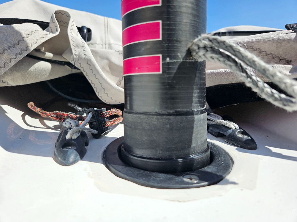

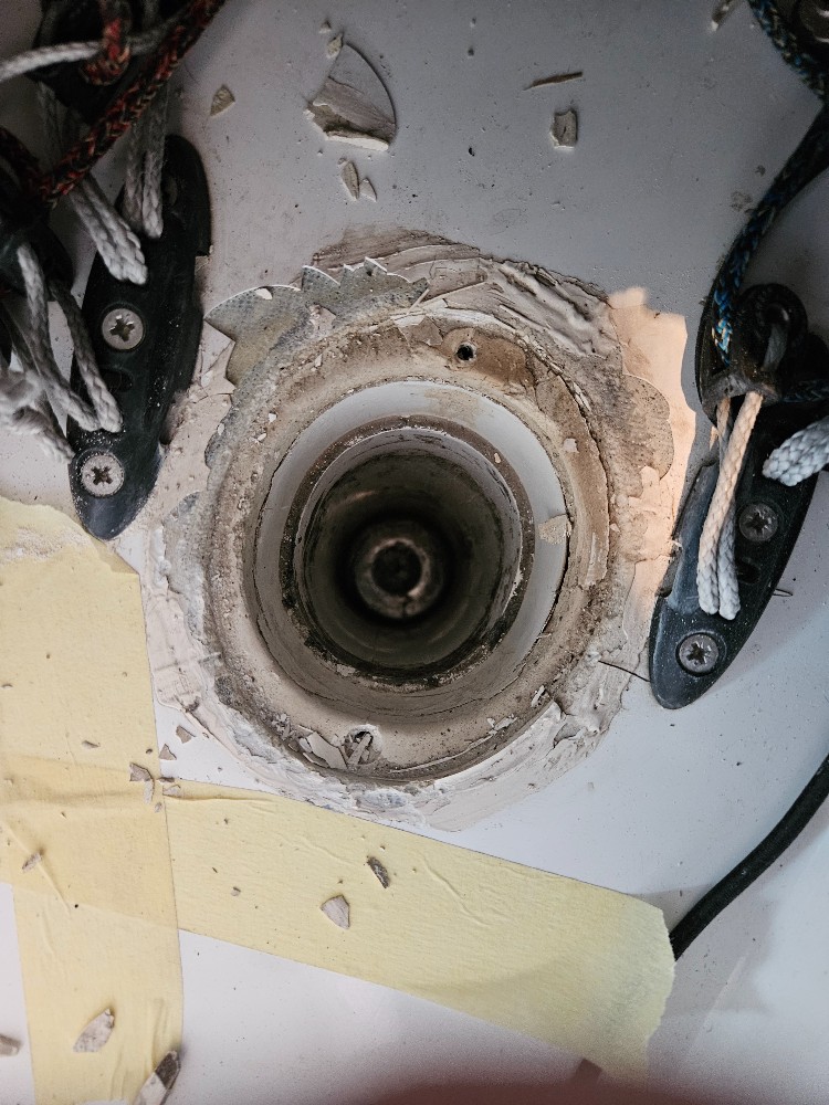

Maciej, if you have already glued in place, you will struggle to get it off. The position of the collar shown in your last picture should be OK. But if the glue separates / fails again, I would be moving the collar up slightly so that the top edge (aft) sits about 5 mm or so above the edge of the mast step.

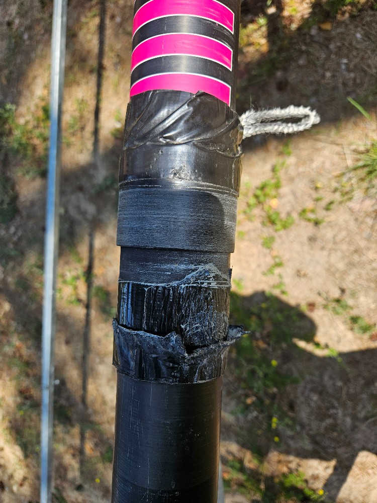

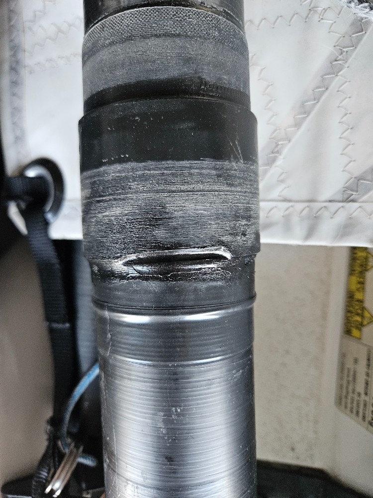

Tape alone will wear out quickly. Use 1 or 2 plastic cable ties above the collar, closed very tightand the top of the collar rotates smoothly against those. Put some tape around the cable ties to hold them in place.
Tape is fine below the collar to stop it slipping down when you take the mast out. All the pressure is upwards when sailing.
