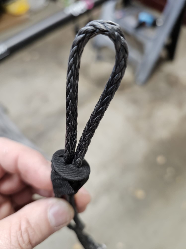

Peter, Ron, Michael, thank you for your help! I had a friend measure the distance between the holes and he said it was 5 inches (basically 125mm) so I could dteremine which one was the original hole. I made the loop with a diamond knot and made a loop with the tails to really tighten the knot. Then I taped a bent stainless steel washer so that the bend would sit correctly inside the boom with the loop oriented correctly.  I fed a fish tape from the hole to the end of the boom to pull the loop and it took a couple minutes. I want to pull another loop through the extra hole and use it to attach a shock cord going through the clew to help ease the outhaul, but I'm assuming that's not legal. Again, thanks for all the help!

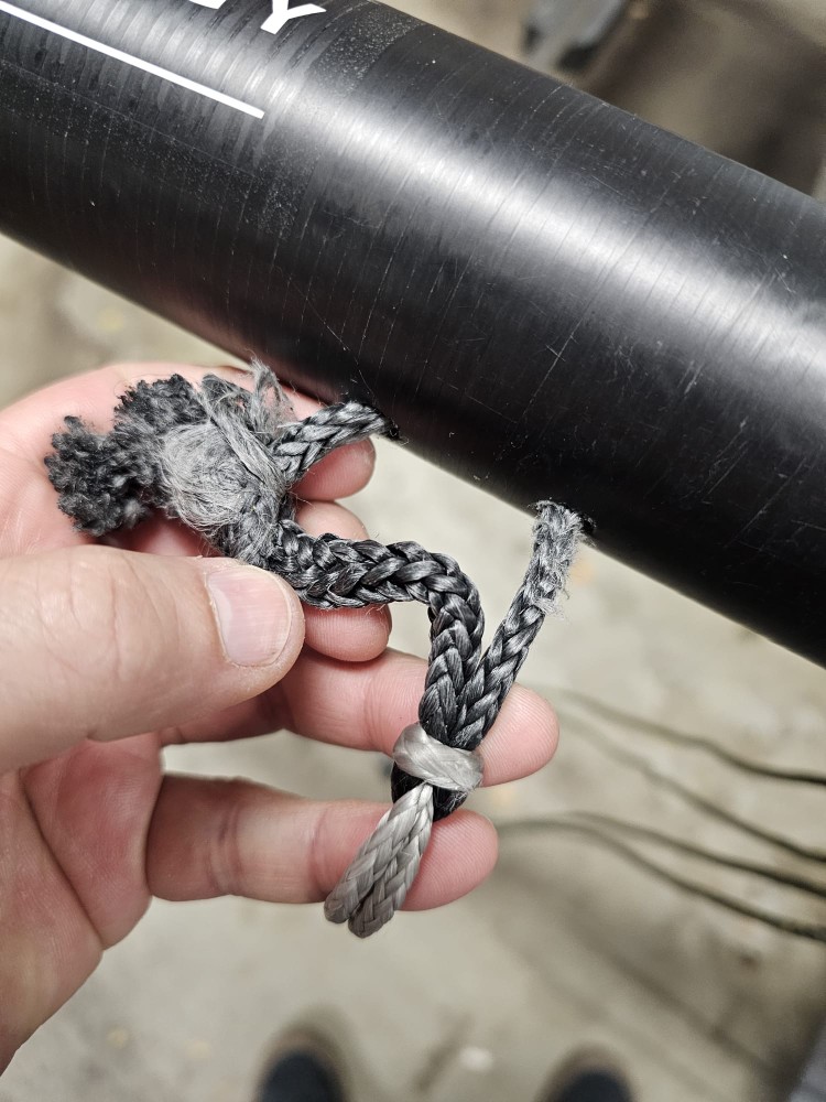

I have previously replaced a vang loop, because leading edge of the dyneema was half cut through by compression against the leading edge of the hole in the boom/internal bent washer.

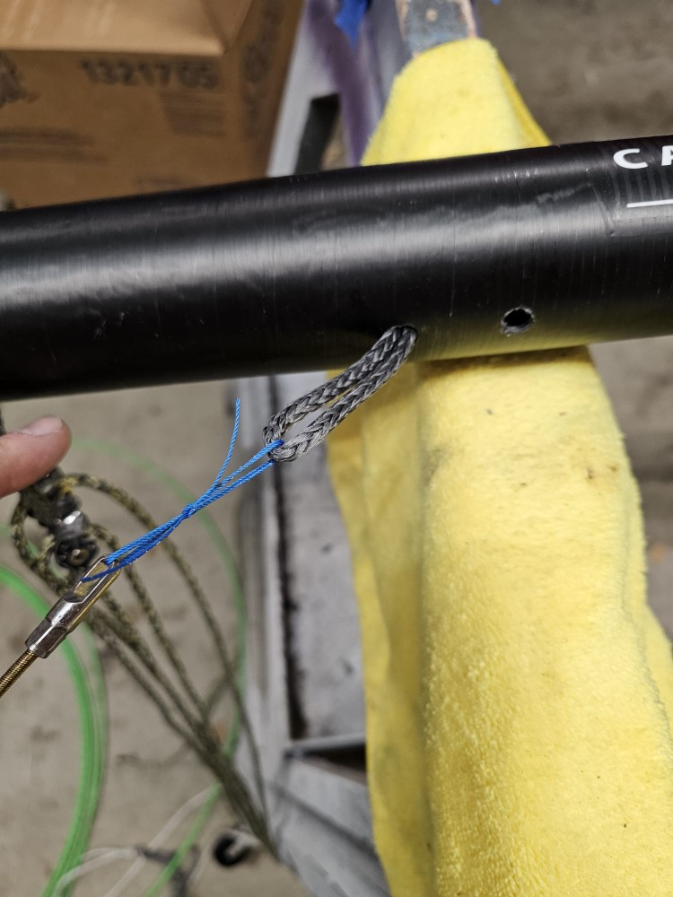

Here you can see in the spare parts list, how it should be:
https://www.rssailingstore.com/Catalogue/RS-Parts/RS-Aero/Masts-Parts
The additional hole looks completely wrong for me.
I assume, that it was drilled instead of making a correct repair, when the dynema loop was worn out.
My suggestion is to rework it to the original status. I would not feel well, because the load is different on the boom as well as it is for sure not class legal.
Once you send me the measurement of these two holes (e.g. the distance from the other vang loop, which looks correctly, I can tell you, which hole is the correct one.
I am not sure, how this is fixed in the boom, because I only changed these lines at the lower Mast. There was a washer inside the mast, maybe this should also be there. Hopefully someone else knows details regarding this.

I recently picked up 3785 and I think the previous owner rigged it differently. The boom has 5 holes for dyneema loops: two for the mainsheet blocks and three for the vang. Is it supposed to only have two for the vang? On my previous boat I don't remember the loop tied outside the boom. The rigging manual doesn't show this extra hole either. I'm thinking about replacing it with a 4mm loop with a diamond knot and a bent washer inside (going through a single hole). Which hole should I use? Any information or suggestions would be appreciated.
