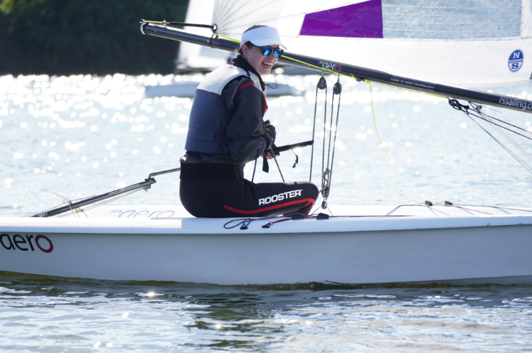

Jonathan,
Adding a cleat which is not permitted within the Class Rules would certainly infringe the Class Rules, however it was attached.
I expect that what you can see in the photo is two clips clipping together to make the shockcord into a loop, as is specifically permitted. You can see the tale of a knot dangling.

It is not so obvious in this scale of photograph, but if you click on the photograph to display it in a separate window it would appear that a new cleat has been fitted under the boom between the kicker and mainsheet block loops.
If fitting that cleat has involved drilling or other permanent fixing then I suspect this is outside of class rules.
CA Technical committee have final say on that aspect, of course.

Andy,
The Class Rules are posted on the Documents page of the website here;
https://www.rsaerosailing.org/docs/876871527(4).pdf
See C.6.1.3 (m) (iii).
Shockcord is permitted to retract or reduce slack in ropes when released/uncleated, with limitations;
- must be maximum diameter 6mm
- can have optional attachment hook/s
- shockcord and/or hook may not change the function or performance of any fitting or rope
- must not pass through or attach to any sail cringle.

If it is elastic it is in my book class legal and I have senn boats at the European passing the measurement checks with such elastic. It is only helpful for low wind conditions,

Looking at the pics from Papercourt event I see this https://www.rsaerosailing.org/index.asp?p=gallery&id=autumn-2022&yr=2022&details=5276
There is a yellow line that would appear to function to loosen the outhaul.   Is this legal & how is it rigged?
