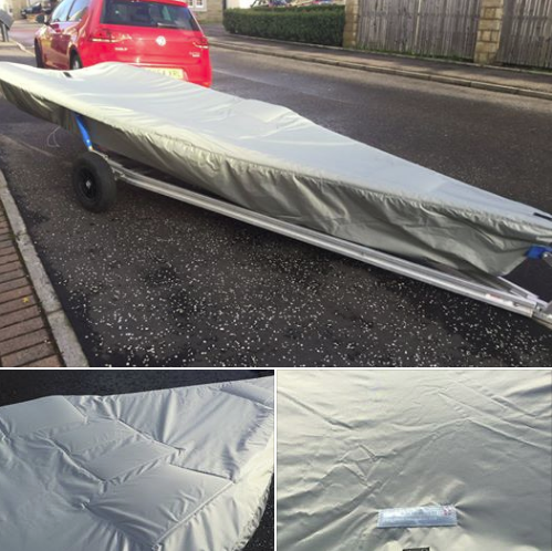

Thanks Peter.
As I mentioned, our local sailmaker has made a bespoke snood based on the one supplied when the boats are new. It is made of a more robust material and has extra padding in the right places. We were planning on doing a bit more travelling this year (including Lymington) but obviously, those plans are on hold just now.
Here is a picture of our new travelling cover.

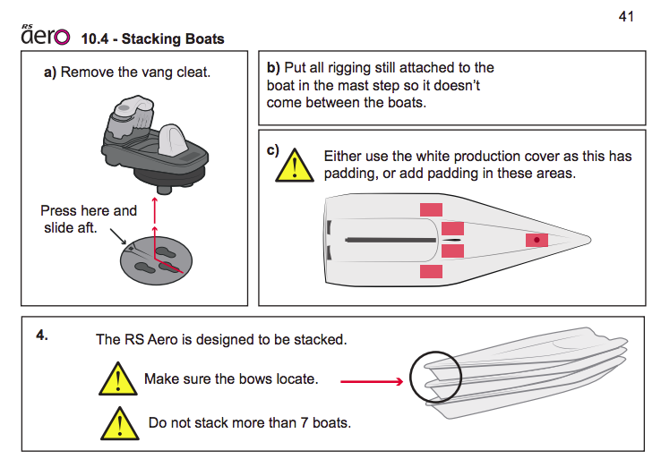

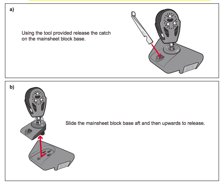

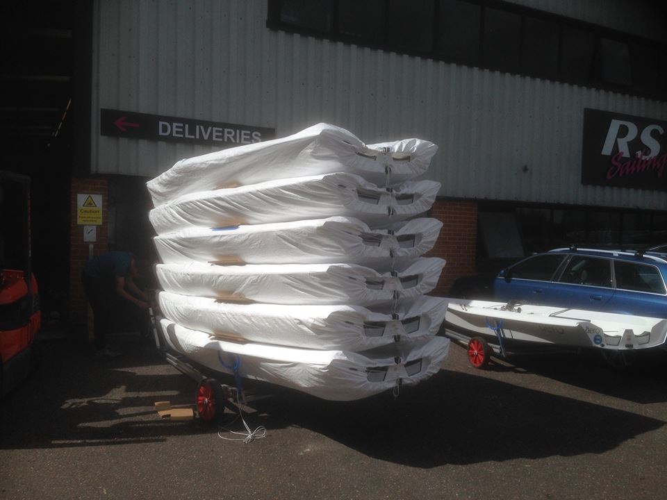

Hi Duncan,
RS Aeros are designed for travelling stacked so when stationary in the garage it is an easy way to save space.
- Remove the quick release kicker cleat fitting
- Remove the quick release mainsheet block fitting (undo shackle on boats pre sail number of about 2100)
- Place all the lines and blocks at the mast step down the mast step
- Add padding in at least the 5 necessary points as per rigging manual
At rest in the garage as the RS Aero is so light you could happily store a load of gear on top of the top RS Aero. They are designed to be stacked 7 high, although tend to be transported with a max of 5.
Refer to RS Aero Rigging Manual pages 41 & 56
