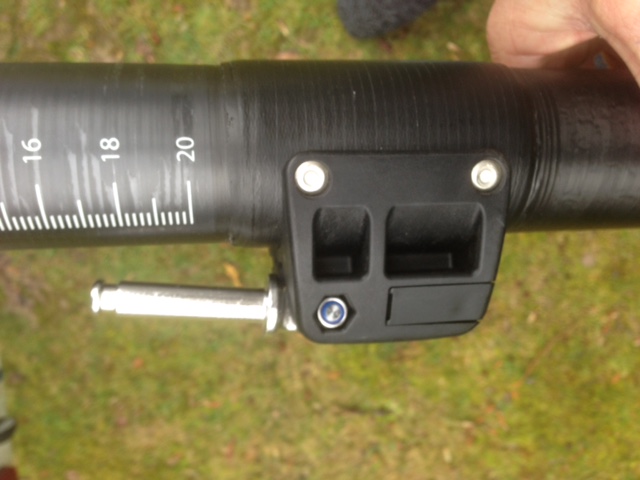

The gooseneck pin is designed to fold up in line with the lower mast. Do this on lowering the mast each time to avoid danger of scratching and also to fit it inside the spar bag.
The gooseneck pin is also designed for the boom to positively click into it, avoiding it accidentally falling off and dropping onto the deck.
