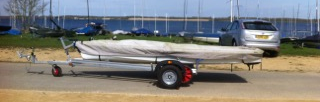

Here's a couple of photo's to prepare you for collection:-
My boat on it's road base.  Unfortunately not on the tow ball, which will be higher than the dolly wheel, but illustrates the transom ground clearance:-

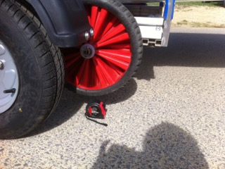

You might notice the clearance under the trolley wheels to the road isn't great.
In fact even with 10 inch road base wheels it's just over 2 inches, or the height of my tape reel, as following picture shows:-
If you go down a sharp bump or kerb you may find the whole rig weight transferring to the trolley wheels.  Probably won't do any damage, but you might want to play safe & take the trolley wheels off!!
Have fun with the boat!!
